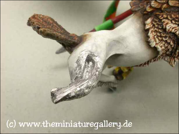

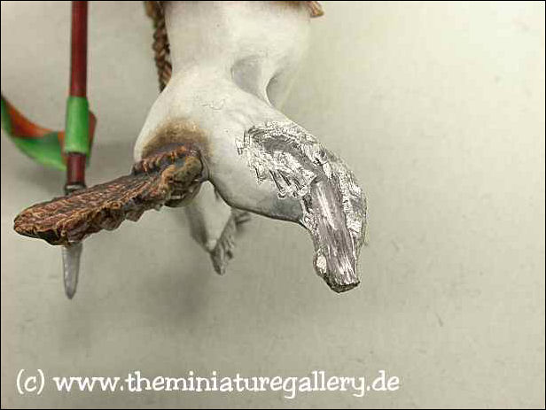

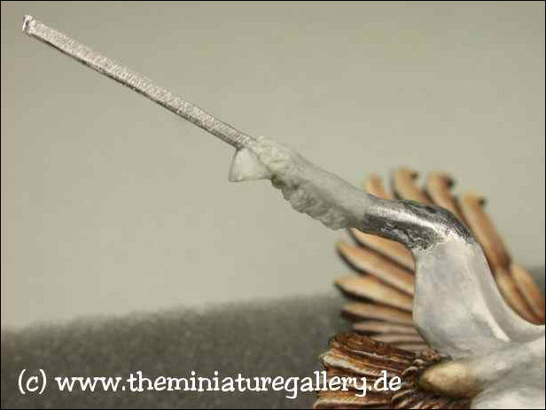

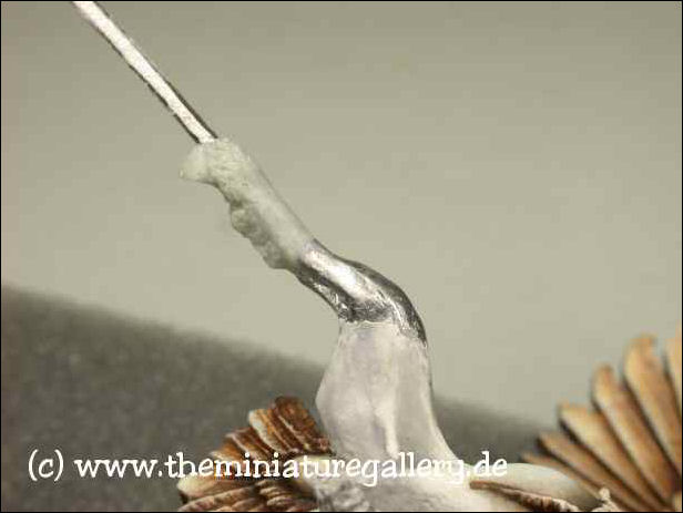

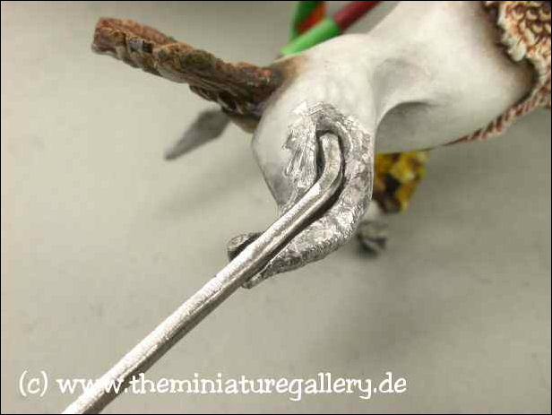

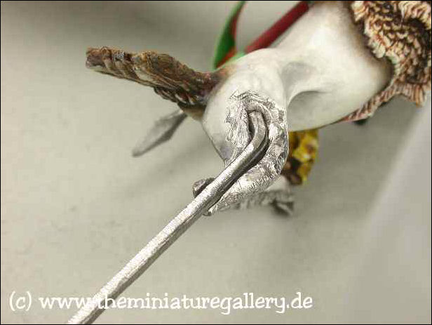

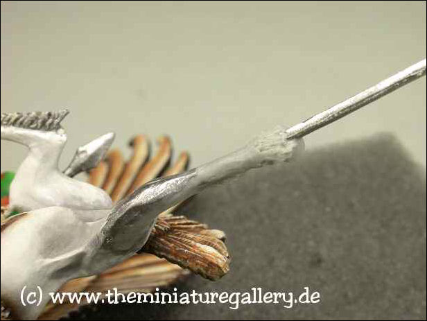

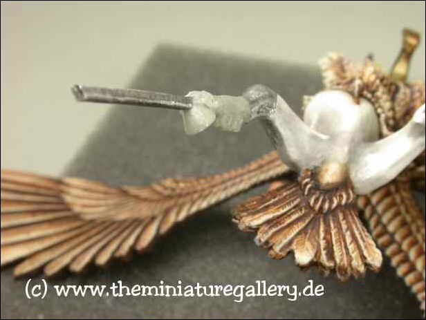

Dirk Posted June 27, 2006 Share Posted June 27, 2006 Hi Mr. Willard! As there have been quite a few helpfull answers allready, I just want to add a few images of a kind of "advanced pinning" I once did on a miniature. (An old classic of mine, called "Hippogryff Rescue") Well, just for your pinning inspiration. To pin this miniature I had to remove the whole lower leg and had to adjust a piece of spring steel wire to it. Then I resculpted the leg with Magic Sculpt and was able to fit the steel wire into the base for a much better fit. Just click the thumbnails. Regards Quote Link to comment Share on other sites More sharing options...
