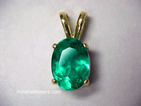

Mengu Posted February 15, 2007 Share Posted February 15, 2007 Color choice would vary. Technique could be approximated as any other solid polished surface. I would ignore its translucency, and make it solid. Here is a picture I like both for the color selection and to give you an idea of how you would paint it: (this looks like another good page to examine) So it would be mostly flat color (probably a smidge darker on the lower side so it fits in with the rest of a mini), with a hot spot/line close to the light source (much like NMM on a round surface, minus the strong shading). Compare to emerald: Transparent gems are going to be darker up top, lighter at the bottom. Quote Link to comment Share on other sites More sharing options...
