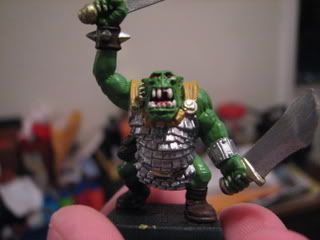

Ravenwood Posted July 23, 2009 Share Posted July 23, 2009 I have been playing with a product called Army Painter "Quick Shade" which is a "dip" mixture tailored for miniature painting. It's a bit on the pricey side, but I'm suprised at 1.) how nice an effect it gives & 2.) the damn near bulletproof coating it puts on the mini. I have thrown minis across the room with no damage to the paintjob (it was an interesting test, to say the least) A quick blast of dullcote kills the shine pretty well. I just apply clean base coats to the minis, let them dry, dip, shake the mini really hard about 6-8 times & then set them down to dry. After 12 hours of drying time, they are ready for basing & a blast of dullcote...Right now, I can crank out about 5 orcs an hour... This is the product: Here is a before, with the basecoats: And here is after drying for 12 hours I'm using the GW orcs as test victims for this technique, just in case it didn't work right, that way I haven't ruined any miniatures I really like & would care about :D Quote Link to comment Share on other sites More sharing options...

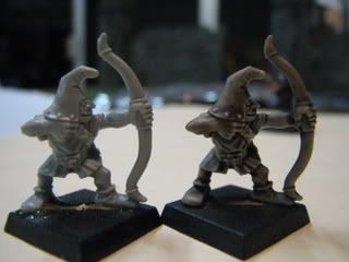

Ravenwood Posted July 23, 2009 Author Share Posted July 23, 2009 More experiments in using quickshade: and quickshade over an unpainted mini, just to see what it would look like I think I've found my new tabletop speed painting technique... Quote Link to comment Share on other sites More sharing options...
jenova Posted July 23, 2009 Share Posted July 23, 2009 Love those results! I must admit that I use the Army Painter dip too. It's just amazing for speed painting. I really can't believe the things you can achieve with it, especially on non-human, very textures sculpts. It's pretty much for me. Quote Link to comment Share on other sites More sharing options...

Ravenwood Posted July 24, 2009 Author Share Posted July 24, 2009 I've heard of people using the minwax products,but does it give it the same hard clearcoat in addition to the shading? I like the one-step, 5 figs an hour painting rate it allows. Finishing 20 minis in a night takes the bite out of painting an army & lets me spend more time on characters Quote Link to comment Share on other sites More sharing options...

jenova Posted July 24, 2009 Share Posted July 24, 2009 Wow, it does look like a good job, but I think you can get the same results with brown liner, GW Wash, and Future Floor wax for a smaller price. I know I definitely can't get the same results with that mixture. The transitions using the quick shade are so much smoother. They almost look blended. It also works as a really good gloss varnish, so the paintjobs are protected really well. I need to take some pictures of the BF's Hordes army at some point. I really can't believe the results he gets with this stuff. Quote Link to comment Share on other sites More sharing options...
