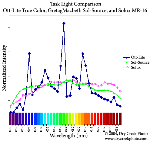

morganm Posted June 5, 2010 Share Posted June 5, 2010 Interesting stuff here; thanks guys for taking the time to talk about this. Where does the often praised OTT light fall in here? I was hoping to see a spectral analysis of that as well. So I dug around the interweb and here's what I found: Discussion and comparison to other lights: http://photo.net/digital-darkroom-forum/007Ue2 Spectral analysis: Seems the OTT-Lite TrueColor has some big spikes as well. Despite it's large spikes; does it seem like a great light because those spikes pop up at all different wavelengths (blue, teal, green, yellow, orange, and red) Where as the N:VISION 'full spectrums' really only spike up 3 or 4 times closer together in the spectrum? Am I way off here? What say you light gurus? Quote Link to comment Share on other sites More sharing options...
Doug Sundseth Posted June 5, 2010 Share Posted June 5, 2010 That's an interesting set of graphs. To a large extent, the appearance of paint under that sort of light will depend on the specifics of the reflectivity of the paint at those frequencies. If you have a narrow reflectivity spike in the same places you have a light spike, you'll get what looks like a very saturated color. If that same narrow reflectivity spike falls in one of the valleys, you'll get a dull-looking color. The big thing, though, is that there really aren't any major dropouts like many ordinary fluorescent bulbs have. You'll get light across the spectrum, so you'll see all the colors, though at somewhat different levels than in daylight. One thing to consider, though, is whether you often see your figures in daylight. (I don't, and most people I know don't either.) If you're really worried about the effect of light on paint, you should probably paint under the same kind of light you will use to view the figure. Use nasty green fluorescents for gaming figures you'll be playing with under the nasty green fluorescents in the game store where you play. Use OTT or GE Reveals for competition figures, depending on what you expect the judges to use. And use whatever lights you have in your display case for display figures you paint for yourself. (Not very satisfying for me, at least, but there you go.) Quote Link to comment Share on other sites More sharing options...
