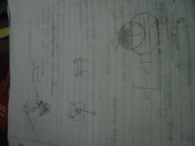

yani Posted August 13, 2012 Author Share Posted August 13, 2012 I forgot to post this, but I covered the steps with greenstuff and left it a little messy, to indicate rough rock. I left it to cure overnight OK, so while waiting for that to cure, I turned my sights onto the second base. I had a lot of troubles with this base, as I painted up Alis Testarossa for a second entry, and her pose, while dynamic, is really awkward to think of a suitable "story" for her. Finally, I found this picture and got inspired by the pedastels that the angels were standing on. So I drew out the concept art and the"technical" piece for the size of the wood I need to cut out: I drew the final piece out on a slab of wood and cut it out. Here it is: I wanted it to fit around a Charles Schwab cork, since the cork had a nice texture. I proceeded to cut out another, identical piece, and a smaller one With a sanding stick, I rounded off the edges a little, and gave the sides and top a good sanding with a 240 then 600-grit sandpaper. I want as smooth a surface as possible since I want a marble-like paintjob. (the 600 had pewter shavings on it, which is why the piece is grey) I stuck them together using glue and now waiting for it to dry! Quote Link to comment Share on other sites More sharing options...
