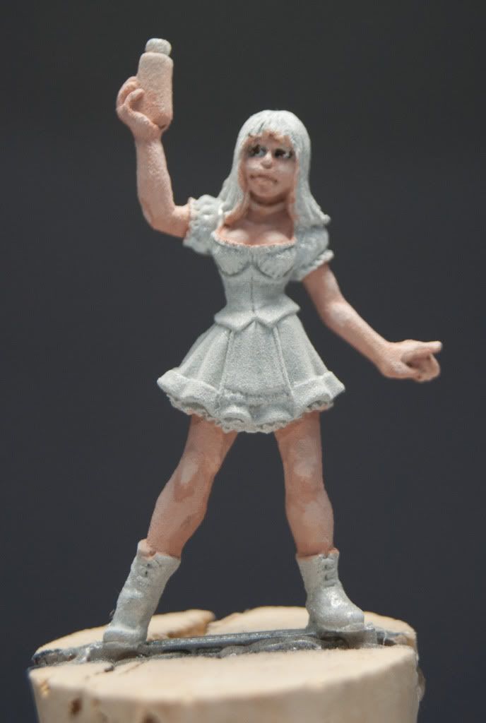

cloudshaper2k Posted September 10, 2012 Author Share Posted September 10, 2012 Two sets of progress photos. This first set is my initial blocking in for shadows and highlights for the skin. Okay, truth is, I took these thinking I was done with the skin . . . then I cropped the images and could see every transition point. So, I put the wet palette away, broke out the well palette and thinned out my skin tones and started blending. Here's the results: Suggestions and critiques are more than welcome, gang. I'll probably start working on her blouse next. Quote Link to comment Share on other sites More sharing options...
psyberwolfe1 Posted September 10, 2012 Share Posted September 10, 2012 It looks like your primer fuzzed on you. I would say strip and reprime if you're doing this for competition. 1 Quote Link to comment Share on other sites More sharing options...
Jordan Peacock Posted September 11, 2012 Share Posted September 11, 2012 What kind of paints are these? It's fascinating to see the steps you're taking so far to get the skin tones, but I'm a bit surprised at the texture. Quote Link to comment Share on other sites More sharing options...
cloudshaper2k Posted September 11, 2012 Author Share Posted September 11, 2012 psyber: I think you're right. Your comment got me doing some research and I'm going to test primer a couple of minis with a different spray technique. While this isn't (currently) for a competition, I'm wanting to get my skills up to that level - so, strip and reprime it is. Jordan: All MSPs - which is why the texture shouldn't be there at all. Quote Link to comment Share on other sites More sharing options...
JackMann Posted September 11, 2012 Share Posted September 11, 2012 Can you go into the spray technique you used here? It's not right for Alice, but I can imagine minis where it would be an interesting texture, especially if you could isolate it to a single part of the mini. Quote Link to comment Share on other sites More sharing options...
cloudshaper2k Posted September 11, 2012 Author Share Posted September 11, 2012 Honestly, when I started researching primer fuzz, it seems to come from overshaking the can or high humidity. I'm putting my money on overshaking for this. One of the sites I looked at suggests it's endemic to white spray primer. I live in Phoenix and even though today was high humidity for us, I've had my primer do this before. I just never thought to seek out the why until now. I suppose it would be a quick and dirty way of texturing a teddy bear mini or other stuffed toy part. Not sure how you'd go about isolating it to one part of the mini, though. Quote Link to comment Share on other sites More sharing options...
Kay Posted September 12, 2012 Share Posted September 12, 2012 I suppose it would be a quick and dirty way of texturing a teddy bear mini or other stuffed toy part. Not sure how you'd go about isolating it to one part of the mini, though. Mask off around the area that you want textured. Blue tape, saran wrap, baggies, paper...... Quote Link to comment Share on other sites More sharing options...
Kay Posted September 12, 2012 Share Posted September 12, 2012 Just wondering, what kind of primer did you use? I just took a few pix of two I have partially done and don't see that fuzz. Quote Link to comment Share on other sites More sharing options...
cloudshaper2k Posted September 12, 2012 Author Share Posted September 12, 2012 Kay, I'm using Armory's primer at the moment. Quote Link to comment Share on other sites More sharing options...
psyberwolfe1 Posted September 12, 2012 Share Posted September 12, 2012 Oh sweet Satan! That is why you're getting fuzz. Armory is quite possibly the world's worst primer. I only use Armory for terrain because I want the texture. The best white primer is Tamiya. Followed by Duplicor sandable auto primer. Seeing that you're in Phoenix you might want to get the spray closer to the figure. I've sprayed from 3"-6" away. Oh and here is an article I wrote on Primers it should help. 1 Quote Link to comment Share on other sites More sharing options...

skippen Posted September 12, 2012 Share Posted September 12, 2012 I had a recent bought of rampant primer fuzz here (in Colorado). It took me a long time to figure out because it was not happening all the time, but enough that it was very annoying. I asked my fellow painters, and I finally figured it out. I was spraying too far away. The primer was drying on the way to the mini. I have not had a problem since I shortened my distance. Quote Link to comment Share on other sites More sharing options...
