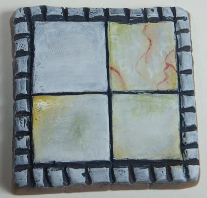

Moving on! I hate waiting for paint to dry. My last step involved some slow drying glazes, so I took this opportunity to move on the other squares, since the one we've been working on is going to need some layering that all the others will as well.
Step 6: Get those other squares done! Starting with the bottom right- Linen white first then I blended in some olive at the top center and saffron at the bottom 2 corners. Note that it is not identical to my other square. We want each to stand out, but the colors will stay the same to make it harmonious.
Next the bottom left square. I tired to do an in progress shot while working fast to keep my paint from drying. It worked! Yay!
See how I put down the olive paint and blended it then blended in the saffron? I'm also using a wash of linen white underneath all of these, just so you know. Last the top square...
Blendy blendy...
Step 7: Lets get lines all over this! First with saffron, darken them, add red, etc. etc, just like we did before.

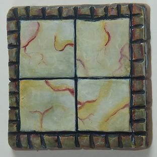

Step 9: Glazing. Lots of glazing. Watch the colors change...
marble36_zps6d015975.jpgmarble37_zpsb32e3c2d.jpgf580e4c1-0645-4c3e-88e9-1958ac104509_zps
First linen white, then saffron, then olive.

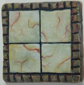

After the glazing I went back to add some more saffron and then darken some of my red lines that got a bit washed out.
Finally I went back over my white lines and then did a final thicker wash of linen white. Now I've got to go back and fix those edges!
