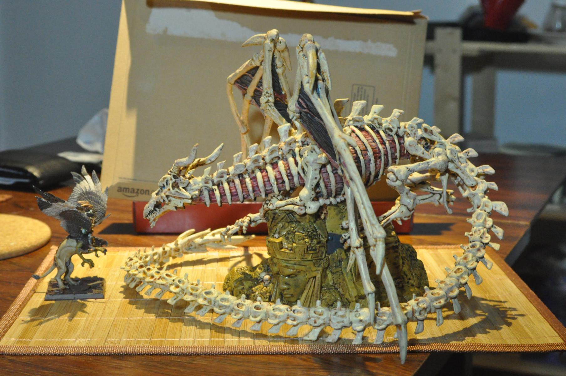

buglips*the*goblin Posted September 7, 2013 Author Share Posted September 7, 2013 (edited) Basecoat secure! Well, mostly. I rushed a little bit on the next part and some not-quite-dry grey came off. So I decided to let it sit a while longer. So what was the next stage? Drybrushing! In this case, more than just an expedient. Kaladrax has a few problems you don't notice until you get into working on him. Chief among these is that his accidental enlargement made some of his details a bit soft. Now, some people believe that after you learn layering and so on that there's no need for the old, primitive techniques any more. Well, I disagree. In this case, I'm using drybrushing to help compensate for the detail loss. As you should be able to see in the picture, using reaper stone grey over the armor grey undercoat with a drybrush results in a textured finish - and I think this will help give the illusion of more detail than there actually is. This is only the first stage for the base, and when it's all through it should (hopefully) look pretty neato. We'll see. But IMO, drybrushing is the way to go here over layering. Your mileage may vary, depending on whether you like that look. And then I set about giving his skull another coat and starting some other bone bits. That center piece had pretty wild flash going on, so I carved out as much as I could quickly. Can't be sure I have enough time to worry it, but there was too much to leave in place. Hopefully any bits I missed won't show up later as glaring defects. And that Bone Shadow is really growing on me. Edited September 7, 2013 by buglips*the*goblin 21 Quote Link to comment Share on other sites More sharing options...

buglips*the*goblin Posted September 7, 2013 Author Share Posted September 7, 2013 The secret to good textured drybrushing is to use a dry brush. I think Psyberwolfe mentioned in a thread recently about drybrushing to moisten the brush, and that's good advice for some uses. But that'll smooth out the texture, so if you want rough like above, don't wet the brush. This will, however, absolutely murder your brush. In this case, I've sacrificed an old Reaper Kolinsky 0 with split hairs. It looks... pretty grisly now. But it should last long enough to finish the task. Paint matters, too. Reaper, at least old pro paint, goes grainy under the drybrush. But other brands, like Coat D'Arms, instead get a gloopy look. Always test before doing it for real. Buglips, I salute you (with paintbrush in hand)! I've been waiting for someone to do a full WIP of this bad boy, and I'm super excited to see both the process and the finished result! Don't kill yourself trying to finish your challenge! Huzzah! --OneBoot :D Yeah, we've had "model ship syndrome" for some of the WIPs. Just one or two pictures with very few in-between stages. That's not a criticism of the effort, the vast majority of WIP threads on internet hobby sites are that way so it's very normal, but like you I always enjoy a WIP that takes you through the process more thoroughly. 2 Quote Link to comment Share on other sites More sharing options...
