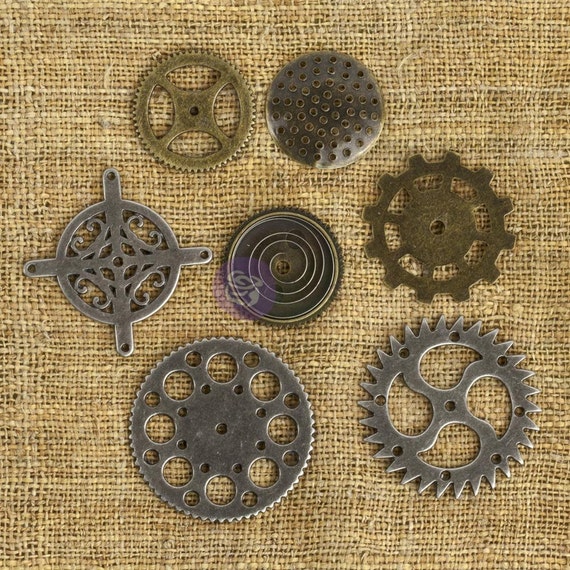

I just checked the JoAnn Fabrics site, and also found something like this (picture from Etsy):
These actually look pretty nice; I might just have to swing by there and see if they have any in stock at my local store.
I've been using epoxy putty and Instant Mold for a few features (mostly for decorating bases, lately -- I hope to have some picture-worthy examples to share later), but the putty doesn't seem to work all that well for anything quite as fragile as wagon wheels with spokes.  I do have some Games Workshop wagon wheels, but those are actually TOO SMALL for the scale of wagon I'm aiming for, for this project.  One of my considerations is that if I can manage to make a master of ONE really good wheel design, I may use Instant Mold to make some push-mold copies for a full set of wheels.  I just have to keep in mind that it's Wednesday already, so whatever I do, I need to make it quick, and putty-curing takes some time.  I only have today and tomorrow.  (Friday night, it's time to pack away all the craft stuff, and clean up the house to be presentable enough for company and set up the table and have all the hand-outs organized, and then Saturday it's time for the game.)
Those Jim Holtz cogs are a godsend for steampunkers. I have a box full myself. They also make other interesting bits like keys, and they have another cog set that's actually nicer, which more "classic-looking" cogs more similar to the ones in your second pic. Michael's also stocks this stuff (Jo-Ann is owned by the same company), so if one is out of stock, you can check the other.
