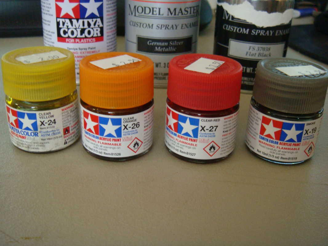

Have you tried any of the Tamiya transparent paints? The reds and oranges are really nice, and easy to work with.
To each their own.  I love the smell of these paints, though its probably no good for me.  the colors can be used with an almost magical quality.  shiny and transparent, they make wonderful easy small gems, windshields and glass, mysterious liquids in glass bottles, etc.  I really love these, but a single bottle will last forever.
And red is a wonderful fresh blood, blue and yellow make great alien goo, and overlaying the gray over another color makes it look like color in a bottle.
If they are "flammable" they are not water-based acrylics.
Tamiya's paints are an acrylic lacquer, its thinner is (to the best of my knowledge) isopropyl alcohol with some acrylic flow aid and retarder. (If you look around online, you can find home-made Tamiya thinner formulas.) As with any reactive thinner, use in a well ventilated area.
I remember quite some time ago purchasing my first bottle of Tamiya X-20 thinner at my local hobby shop. I brought it to the counter and the shop employee looked at it and said: "Let me save you some money. Open the bottle and smell it."
A little unsure, I did what he said. He said: "Remind you of anything? Smells a lot like rubbing alcohol, doesn't it? I use that as a thinner all the time and it's a lot cheaper."
I showed my appreciation by using the money I saved to purchase more colors.
